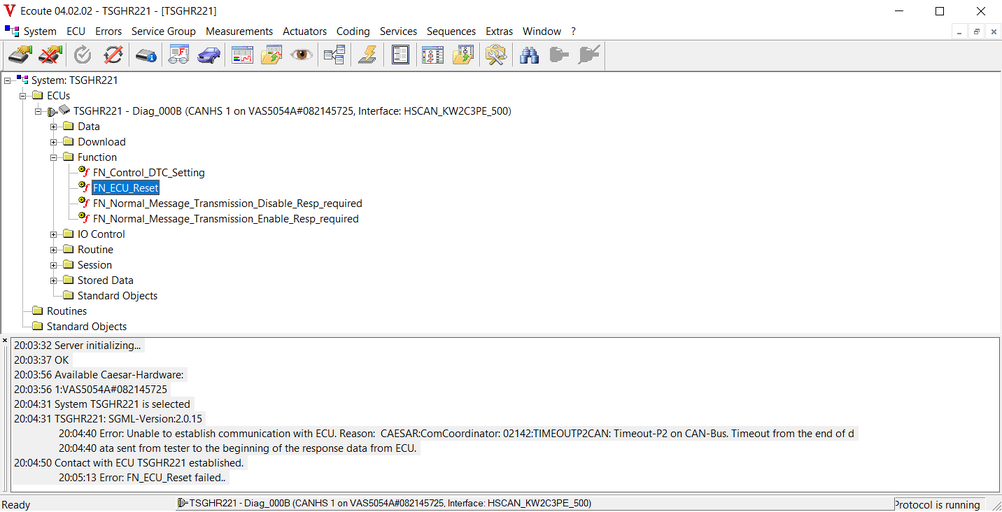

Подскажите, как получить доступ к возможности Reset блока двери W221?
18:56:58 TSGHR221:
50 81
18:57:01 TSGHR221:
50 92
18:57:01 Request:
1A 87
18:57:01 TSGHR221:
5A 87 01 07 00 0B FF 06 10 06 40 18 32 32 31 38
37 30 34 34 38 37
18:58:41 Request:
11 01
18:58:41 TSGHR221:
7F 11 11
0x11serviceNotSupportedThis response code indicates that the requested action will not be taken because the server does not support the requested service. The server shall send this response code in case the client has sent a request message with a service identifier, which is either unknown or not supported by the server. Therefore this negative response code is not shown in the list of negative response codes to be supported for a diagnostic service, because this negative response code is not applicable for supported services.
the server does not support the requested service - значит данный блок не поддерживает эту функцию, верно понял?
