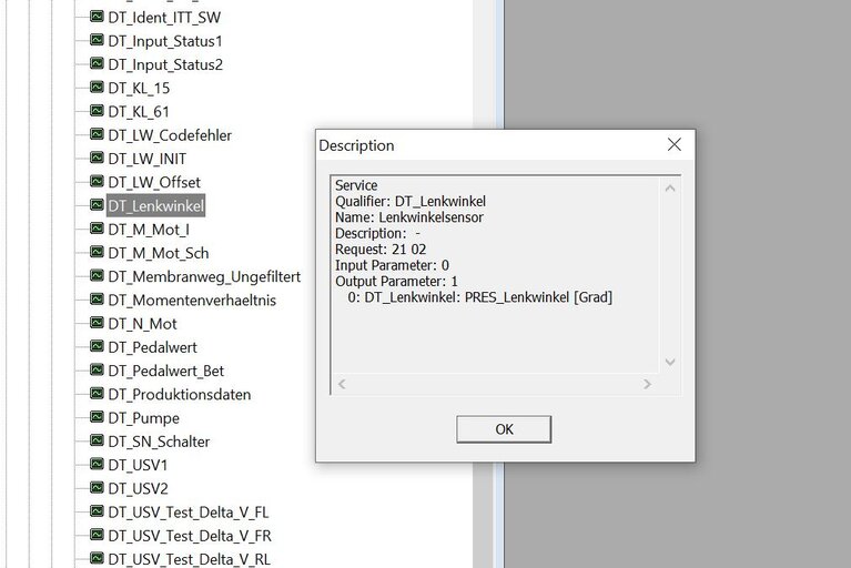

I am reading the steering angle from the W203 Esp unit. I want to turn on the fog lights using arduino according to this angle. But I could not decode the HEX data.
Angle data:
Request: [21 02]
Response: 8B F3 34 [61 02 FB FF C5 FE FF 00 F0 00 02]
