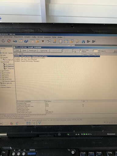

Подскажите, в этом блоке крэш дата стираеться или всеже блок пришёл поврежденный?
DTC_OCCURRENCE_FLAG: Fault;
DTC_WARNING_INDICATOR_FLAG: active;
READINESS_INDICATOR: not supported;
DTC_PRIORITY_VALUE: 1;
ENGINEERING_NOTES: Rollover sensor failure.;
CUSTOMER_PERCEPTION_SYMPTOM: "Seek service station";
POSSIBLE_CAUSES: ORC defective;
REPAIR_ACTION: Replace ORC;
ENABLE_CONDITIONS: tbd;
MATURE_THRESHOLD: Any subfault condition met;
MATURE_TIME_VALUE_UNIT: Depends On subfault;
MONITOR_TYPE: Startup / Continuous;
MONITOR_RATE_VALUE_UNIT: Depends On subfault;
NUMBER_OF_TRIPS_ACTIVE: 0;
DE_MATURE_CRITERIA: None - CCG: Latched for the ignition cycle. And Latched indefinitely once occurred on 2 consecutive. MCG: Latched indefinitely on 1st occurrence.;
DE_MATURE_TIME_VALUE_UNIT: 0;
LIMP_IN_ACTION: n/a;
STORED_DTC_SELF_HEALING_CRITERIA: no self healing
