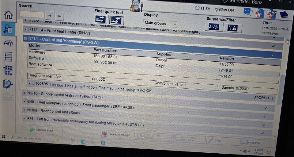

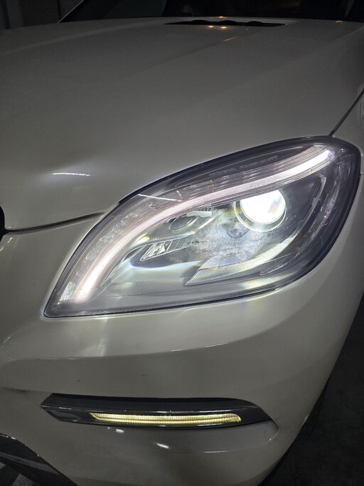

I have w166 and I installed ILS on it yesterday using some halogen-to-xenon (ILS) upgrade adapters. The adapter supplier also sent an OBD adapter that was used for encoding.
Everything works except for the дальний свет and the turning beam in the left headlight, and the dashboard displays the message 'intelligent lighting doesn't work'.
Checked with Xentry, and only this saved error appears that can be deleted, but it reappears after.
Has anyone had something like this before? Do you know any potential solutions?
Switched the xenon module between the headlights, the problem remained.
Is there any potential need for coding or calibration? I checked the coding in HLC166 with some coding dumps, and no abnormalities were found.
